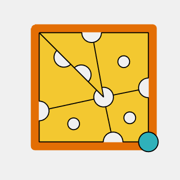

I began with this photo of the Mighty Cheese puzzle.

Theta
The key to the puzzle's geometry is the purple axes in this picture. They cross at right angles at a point in the center hole at the tip of the protruding slice. The angle between the purple axes and the orange vertical/horizontal axes can be measured accurately on the photo and everything else follows. The angle is
theta = atand((y(b)-y(a))/(b-a)) = 11.96 degrees

The solution
The three holes in the original cheese slices do not appear to serve any purpose. So, I have moved them and given them an important role in this simulation. Combine the two triangular slices in the upper left into a single slice. Rotate each of the resulting four slices by an angle of 180-theta = 168.04 degrees about its center. The four right-angled corners from the central hole go to the corners of the puzzle while the outer corners form a central square just large enough to hold the mouse.
That is really elegant.
